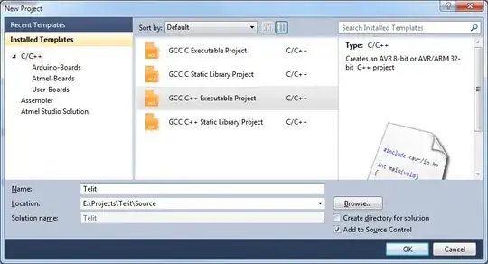

I recently installed Atmel Studio 6 and upgraded a project that had to be manualy recreated so I thought I'd document the process including use of an AVR Dragon. The first step was to create a new project and as my code was C++ I selected GCC C++ Executable Project:
Project creation

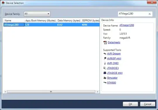

The next step is device selection, a search facility is provided that saves sifting through the entire list of devices:
Device selection

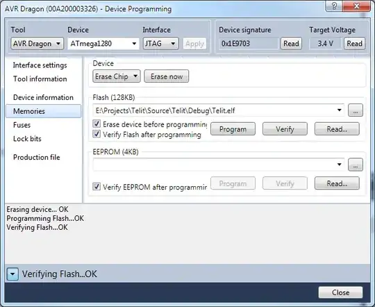

Once that's been saved you can click on the device programming icon on the toolbar or press Ctrl + Shift + P to get to the device programming screen.
Device programming toolbar
Once you've confirmed the correct tool, device and interface is selected you can press the apply button to connect. It's likely the AVR Dragon will require a firmware update to work so press the upgrade button if prompted to do so and wait for the upgrade to complete.
Device programming screen
Once connected you'll be able to read the device signature and target voltage to confirm the connection to the target is OK. You can also program the various memories, lockbits and lock bits from the same screen.
Device programming
