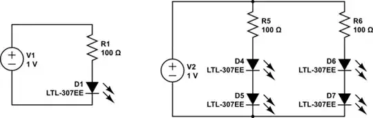

I used a calculator which produced the following results:
ignore V & R values in schematic, the left one was a suggested repeating pattern for the 4.5V source for all 20 leds, the right was suggested for 9V source which repeated for the remaining leds

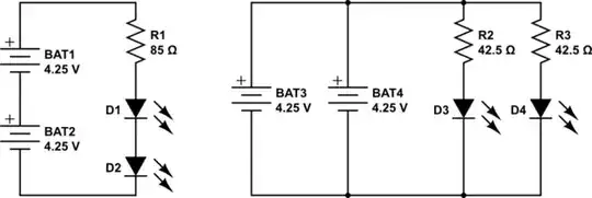

It doesn't really matter how you arrange the LEDs, series or parallel, from an efficiency standpoint. Consider these two circuits:
Each has two LEDs, with the resistors and battery voltage selected such that 20% of the voltage is dropped over the resistors, and 20mA in the LEDs.
The power in a resistor is given by \$P=I^2 R\$.
Power in R1: \$ (20mA)^2 85\Omega = 34mW \$
Power in R2 and R3: \$ (20mA)^2 \cdot 42.5\Omega \cdot 2 = 34mW \$
This is the rate at which the resistors are converting electrical energy (and indirectly, your battery's chemical energy) to heat. As you can see, it's the same for either circuit.
There is also some power lost in the batteries, by their internal resistance. But it can be seen that the current through any of these batteries is the same. BAT1 and BAT2 must supply 20mA. BAT3 and BAT4 must supply 40mA to power the two parallel LEDs, but since the batteries are also in parallel, each supplies only 20mA. Since the current is the same in all the batteries, the losses are also the same.
However, if you really want to stretch your battery life, a resistor is not the way to ballast your LEDs. See How can I efficiently drive an LED?
