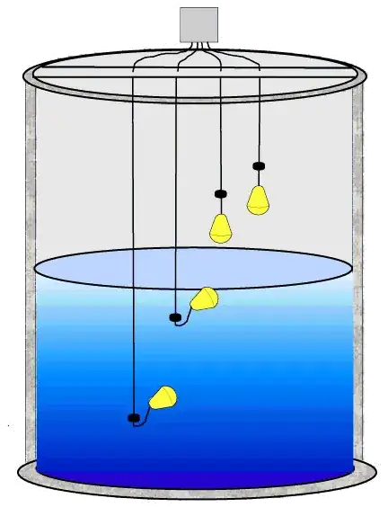

Too Complicated/Expensive/Unreliable
The approaches you suggest require expensive and power-consuming hardware with complex signal analysis to extract water-level information.
All you need is a few $4 float switches arranged at different depths like this:
array of descending float switches
I had suggested this approach to another similar question.
Now, life is really simple. Each of the switches corresponds to a different water level (you might want eight of them 1ft apart?). As the water level changes, more (or fewer) of the switches will be closed.
This can be read with digital logic or a microcontroller extremely easily.

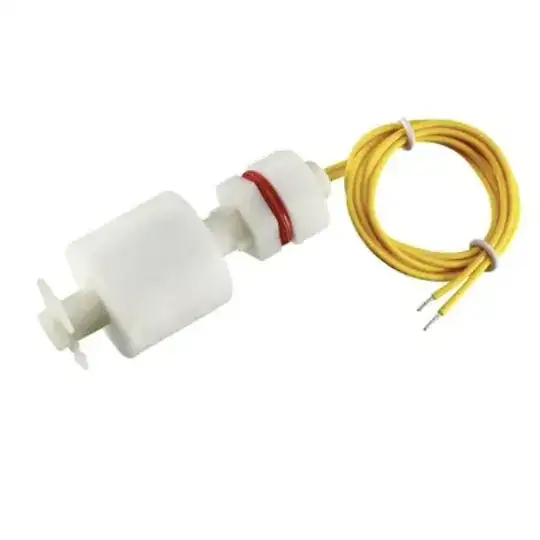

For a "set and forget" level of reliability, I would suggest using magnetic float switches. They are fairly cheap and have no moving parts that need a water tight seal.
magnetic float switch internals magnetic float switch
Use a stainless steel rod or any other non-corrosive material to hang 8 of these in a row so that they can trigger at the different water levels. You can get right angle switches, too, so it is easier to mount on a vertical stick.
Each of these switches needs to be connected to a micrcontroller pin and ground. The terminal connected to the microcontroller pin must connected to a pull-up resistor (1K ohms would suffice) to the microcontroller's Vcc (5V for an Arduino Uno or 3.3V for a NodeMcu board.) A small capacitor (100nF) parallel to each switchs' terminals would be helpful to reduce switch bouncing noise.
Assuming the switch is open when there is water at its level, then the input will be high and the level calculation can be as simple as: (assuming Arduino-like code)
int waterLevel = digitalRead(sw0) + digitalRead(sw1) +... digitalRead(sw7);
If the switch is closed when there is water at its level, then change that to:
int waterLevel = !digitalRead(sw0) + !digitalRead(sw1) +... !digitalRead(sw7);
'waterLevel' will then vary between 0 and 8.
