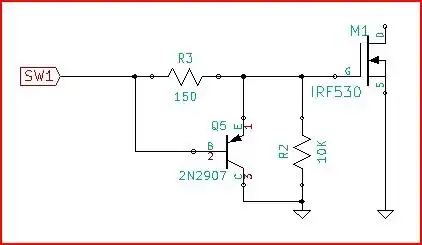

Both of these problems with the gate circuit could be solved by adding a pnp transistor to pull down the gate during turn off. Here is an example circuit to give you an idea.
This is an emitter follower pull down for the gate that effectively divides gate circuit resistance by transistor \$\beta\$.
