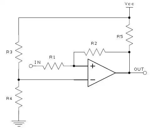

In short: a comparator-with-hysteresis compares a fixed voltage with a temperature-dependent voltage and shuts down the series transistor while it trips.
  • A fixed-voltage source is fundamental part of any voltage regulator.
  • A temperature-dependent voltage source can be as simple as a diode. The challenge for IC designers is to make the temperature-independent voltage source!
  • a comparator with hysteresis is a fundamental circuit: positive feedback is the key.

  • Thank you for the answer. This seems consistent with [the US patent](http://www.google.com/patents/US4667265) that was referenced in one of the comments. I was aware of a comparator circuit, but never realized its easily extended to include hysteresis. – Rev Jun 10 '13 at 13:53
  • And I always thought that the obvious could not be patented... – Wouter van Ooijen Jun 10 '13 at 14:10
  • That's the US for you... – Spoon Jun 10 '13 at 21:29
