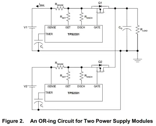

The highest performance (most power efficient/coolest) method is to use a FET OR-ing setup. Their primary advantage is a near-zero voltage drop, limited only by the RDS(on) of the FET and current sense resistor (10 mΩ total resistance is fairly easy, but 1-2 mΩ if you really need).
Controllers for said systems typically use a low-value sense resistor and appropriately-sized FET to connect the power supply to the circuit. It measures the voltage across the sense resistor to ensure current is flowing in to the device from its supply, rather than being siphoned off from the other supply, then the FET does the switching. Some controllers don't use a sense resistor and just measure across the FET.
Here's an article on Digi-Key's site about ORing controllers.
Furthermore, if your system uses a mid- to low-current (<5 A), there are even controllers with integrated FETs, so your component count can be super low. But if you're in the low-current range and if you can get away with the voltage drop of some ORing diodes (0.3 V for some Schottkys), you're not going to beat them on price.
Anyways, several suppliers make these controllers (search for "power supply oring controller" on Google/DK/Mouser/etc.), to name a few: TI, Linear, Micrel, IR, Maxim, and Vicor.

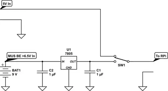

The easiest solution (Initially suggested by @PeterJ) Would be to simply switch only the power connection:
Alternatively, you can probably get away with just using some schottky diodes:
simulate this circuit
Wow, Circuitlab is a clumsy tool. It doesn't have entry/exit ports? Or Schottky Diodes? Really?
But if you're really loading your RPi or it's USB ports, the drop in the diodes could be large enough that you get brownouts, which would be a real pain in the ass to diagnose.
The best solution, I think, would be to put the diodes before the voltage regulator.
This would mean you would have to have a higher power supply voltage (>7V), but it would solve the problem with the diode Vf described above.

  • A 0.5v drop is too much for the RPI. It's spec'd for 4.75 to 5.25. And it pulls up to 700mA. So you would need a diode that can handle that, and still produce a small voltage drop. – Passerby Jun 06 '13 at 03:16
  • @Passerby - As I said, they should be schottky. Circuitlab is just crap, and doesn't have schottky diodes. – Connor Wolf Jun 06 '13 at 03:17
  • Using mosfets instead of diodes would be better, but I didn't want to add that complexity. – Connor Wolf Jun 06 '13 at 03:20
  • I understand that. A schottky would still produce too much of drop with a 5v supply (1N5819 has a 0.6v drop at 1A), where the RPI would not work. – Passerby Jun 06 '13 at 03:38
  • @Passerby - The nominal draw of a RPi is ~200-400 mA (at least from my measurements), so I think it would squeek by. Big devices on the USB ports could cause an issue, though. – Connor Wolf Jun 06 '13 at 03:40
  • @Passerby - Significant edit, please comment on it now. – Connor Wolf Jun 06 '13 at 03:48
