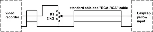

I had a similar problem, digitizing VHS through a composite video output using EasyCap USB dongle. The bright portions of the output were saturated white, and there was no option to reduce the brightness on the videorecorder.
I split the coaxial cable near the videorecorder, and added a series potentiometer as sketched. 2 kOhm were probably too much, but with a very slight movement, introducing roughly 50 to 100 ohm to the central conductor, the signal was attenuated to ca 50% of original brightness, which was exactly what I needed. The colours were not too much affected; I have read the chrominance is phase-encoded in the signal.
(It required some tweaking. With increasing resistance over 200 Ohm, the signal quality deteriorated, becoming blurred, dim and the colours went weird.)
Everybody would say this is not the correct way to do it. But it was perhaps also the only way, since I found no brightness adjustment in the VCR nor in computer. To conclude, nothing blew up and this utterly nonstandard and amateurish modification has fixed my problem.

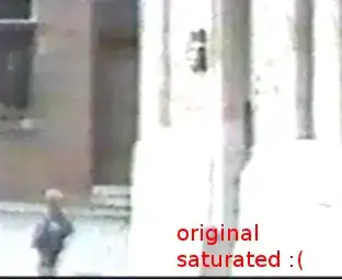

EDIT: For comparison, I created screenshots of the recorded videos before and after the modification.
Original saturated Cable modified
