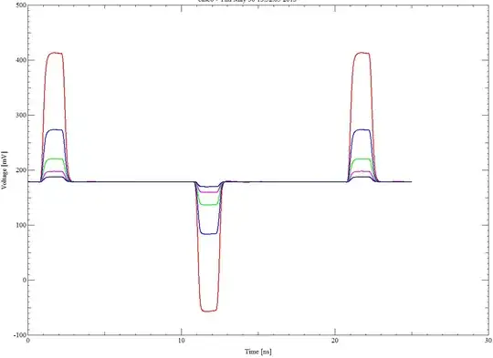

Simulating the crosstalk show this for 5 different trace-to-trace spacings (0.1mm to 0.5mm):
So you can pick 10mV crosstalk just by using 0.5mm spacing and that will be very quiet for the LVDS lines.
