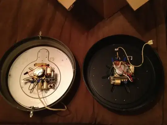

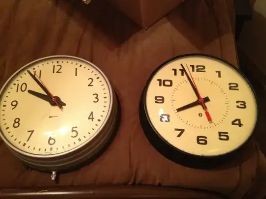

EDIT: Here are some photos of the clocks in question.
