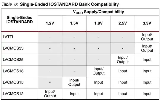

As you posted above, we can consult the Xilinx datasheet for the device family, DS312. Supported IOSTANDARDs are set by the VCCO of a given bank. Notice that input and output are supported only when the number in the IOSTANDARD matches the voltage; input is supported for anything equal or lower.
Spartan 3E IOSTANDARDs

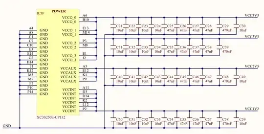

Now look at the last page of the Basys2 schematic.
Basys2 FPGA power
It appears that all the VCCO's are connected to 3.3 volts. This means that you can do LVCMOS33 input/output, and all other LVCMOS input. You cannot do the LVCMOS18 output that you would like to do. If the UCF was set up for LVCMOS33 on all the other pins, the tools would recognize the impossibility of what you're trying to do and give an error. As it stands, the IOSTANDARDs in the UCF are blank, which default to LVCMOS25, and so the tools detect a mismatch.
You might be wondering why Diligent set up their UCF the way they did, since everything defaults to 2.5 volts when the board is actually 3.3. I don't know. The point is that the FPGA accepts pin settings without complaint, as long as the settings are consistent within the bank; it's up to you to make sure the external voltage matches. So you could "fix" your problem by setting a whole bank to LVCMOS18, but then you would probably fry your SPI device with 3.3 volts.
The way I see it, you have several options.
  1. Serious surgery on the Basys2 board, changing the VCCO's appropriately. Probably not worth it.
  2. External level shifting circuitry. You can read the serial input just fine, but the other SPI signals have to be shifted down. You can either do this with something like an 74LVC series logic chip, some series FETs, or just resistor dividers.
  3. Current limiting resistors. This method relies on the clamping diode in the target device to limit the voltage, and the resistor limits the current to a safe level. There are resistors out to the PMOD pins, but they're probably not enough. Do due diligence if you choose this option.

  • "You cannot do the LVCMOS18 output that you would like to do. That's why the tools are giving you an error." It's correct that LVCMOS18 can't be used with this board as is. But that doesn't explain the error. The tools know nothing about the board schematic. If you ask for LVCMOS18 they will assume you are providing an appropriate VCCO. – The Photon May 23 '13 at 03:28
  • "because the tools will gladly give you a bitfile that ends up burning out your FPGA due to incompatible IO" is not strictly true. There is no harm to the FPGA in selecting a different I/O Standard to the Vcco for that bank. The table you quoted shows that you can use a I/O standard as an input with a higher voltage Vcco. Any damage to the FPGA would be from applying a voltage to an I/O that exceeds the absolute maximum ratings specified in the datasheet. The tools have no idea what you physically hook up to the chip and therefore can not be responsible for "burning out your FPGA". – Amoch May 23 '13 at 04:17

  • You must connect the VCCIO pins for that bank to an appropriate power rail. +3.3v for LVTTL, +1.8V for LVCMOS18. Otherwise bad things could happen. –  May 23 '13 at 03:03
  • As mng mentioned I think the only way to set VCCIO is to Frankenstein the board and I do not know where to begin on that... How did you figure out the bank numbers so quickly? It took me a while to go about matching it up from schematic to chip. I guess level shifting is the only sane option. I am wondering what is the better option: level shifting on SPI lines going to the FPGA, or the data coming into the SPI chip (which would be 3.3v coming out of the SPI chip). I am planning to run at the 10 Mhz spec of the MCP23S17 port expanding chip. – MLM May 23 '13 at 03:34
