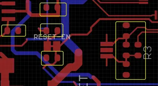

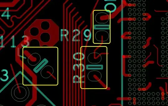

I'm learning to layout PCBs and lately I came across practice that made me curious. The chip passives' pads are etched with oblong / rounded shape, instead of rectangular shape that is used in all example libraries and even the IPC-7351B standard (you can download LP Viewer for free registration and see for yourself). Here are the examples (I marked the interesting pads with yellow):
The question is: what are these rounded pads good for? Should I use them instead of rectangular ones to make my board look more "pro"?
My first thought was that it might be because it might be better for reflow soldering, but I'm bit puzzled about that reasoning. The one advantage I see with these is more routing space around such rounded pad (no "sharp" edges).

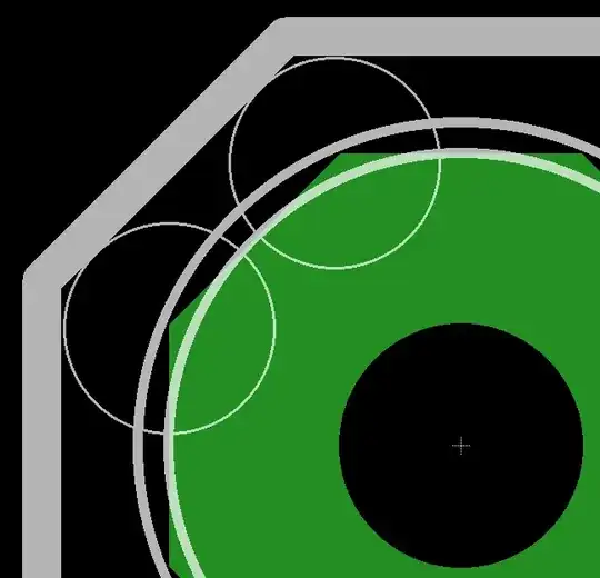

However, I route at 45 degree angles, so an octagon is a better shape than a round pad. It minimizes the space required of the trace around the pad, while simultaneously maximizing the area of said pad for soldering strength, board-to-copper adhesion, and heat dissipation. Here's a diagram in hopes that it will help you see why.The diagram is for a through-hole component, but the same logic applies to SMDs.
trace rounding octagon at even spacing
The 135o angles are better than 90o; but I'm not convinced that going to fully rounded corners is significantly better than 135o. Also, (insignificantly)I like the uniform look that octagonal pads and 45 degree routing produces; I think round pads look out of place.
