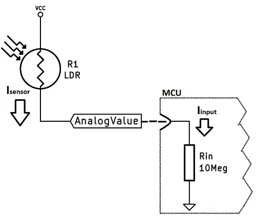

What if there was no pull-down resistor?
If there was no pull-down resistor, the configuration would be as shown in below diagram. The sensor current, \$Isensor\$ would be the same as \$Iinput\$, since all the currents on a wire are the same. Our microcontroller measures the AnalogValue, the voltage on the pin.
Let's calculate the values for this scenario, too:
We know that \$Isensor=Iinput\$, now let's assume, again, that LDR is \$10k\$, AnalogValue is calculated as follows;
\$Vanalog=Isensor*R_{in}\$, where \$Isensor\$ is \$\dfrac{Vcc}{R_1+R_{in}}=\dfrac{5}{10k+10M}\approx500*10^-9\approx500nA\$
Thus, \$Vanalog=Isensor*10M\approx(500*10^-9)(10*10^6)\approx5V\$
As you can see, since almost no current flows, there is almost no voltage dropped on the sensor and even though we could read 2.5V on the previous proper configuration, we have read 5V with the same light, i.e. when \$R_1=10k\$. This configuration will not work.
