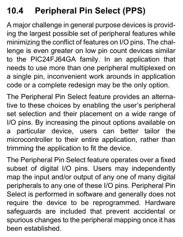

In addition to @CamilStaps answer, there is another context where "alternate pin function" is a commonly used term.
Some microcontrollers have the option to switch their internal peripherals between several sets of IO lines. This way, you can avoid issues if you want to use internal modules (SPI, I2C, etc...) that have their functions mapped to the same set of pins.
There is generally a control-register that determines which set of pins the various peripherals are mapped to.
I know I've worked with a microcontroller that had this facility, but I'll be damned if I can remember the specific part-number.
Edit: Found it - It's available on many of the PIC24 and dsPIC parts:
They call it "Peripheral Pin Select", but it's basically a mechanism for configuring the alternate pin functions.
