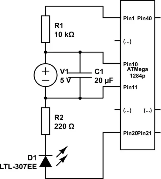

This is my breadbord-setup. Between VCC and GND I have a 20pF capacitor as per the Atmel instructions.
Any ideas what I am doing wrong here?

    While the ASCII diagram is better than none, this site has a somewhat usable schematic editor integrated into it, Circuit Lab. You can invoke this editor by using Ctrl-M while editing your post. Please consider replacing the ASCII art with a schematic. – Anindo Ghosh May 18 '13 at 14:05
  • Thanks for the tip - hope I have done everything right. The editor is a bit of a, well, struggle under OS X and Chrome... But a fine tool nevertheless. – Christian May 18 '13 at 14:32
  • are you sure the polarity of D1 in the schematic above is correct? If you want pin20 to be able to turn the LED on you need it to go the other way. – Gorloth May 18 '13 at 16:54
  • @Gorloth You're correct, I'm just bad with Circuit Lab. I have it in the correct way on my board. – Christian May 18 '13 at 17:08
  • What is the purpose of R1? Furthermore, the diagram as shown should blink arduino digital pin 14, not 13. – microtherion May 18 '13 at 18:35
  • Does ATmega1284p really only have a single Vcc and a single GND connection? You should really should connect AVCC (= +5V) and the other GND pin too. – jippie May 18 '13 at 19:13
  • Did you connect 20pF or 20uF? At least use a separate 100nF capacitor across the controller's Vcc and GND, as close to the controller's pins as possible. – jippie May 18 '13 at 19:16
  • You changed the fuses, can you still program your AVR? – jippie May 18 '13 at 19:17
  • What is the exact program you flashed into the AVR? – jippie May 18 '13 at 19:19
  • @microtherion I got that one from the app notes, it works without though (as I just noticed from a barebones No-Arduino-Things-Involved example I tried). – Christian May 18 '13 at 19:20
  • @jippie 20pF of course, my bad. That drawing of mine gets worse and worse. I can set the fuses with the HVPP on the Dragon AVR. I have tried powering AVcc and it's GND, too, no avail. The barebones example work without them being connected. Don't I just need those if I do anything with the analog in/out's? Using the Arduino IDE I flashed the Blink example, the barebones example is at http://pastebin.com/jRJi3i9G – Christian May 18 '13 at 19:22
  • Please add the source program to your question and change 20pF to 100nF or put them in parallel if you insist on keeping to 20pF – jippie May 18 '13 at 19:23
  • You have to figure out the mapping between Arduino pin numbers and AVR pin numbers. Not sure if they are defined for an 1284 though. – jippie May 18 '13 at 20:21
  • Why do you want HVPP? – jippie May 18 '13 at 20:23
  • Maybe you should clean up your question a bit and make the title more current. You probably should have made a separate question somewhere along the line ... – jippie May 18 '13 at 20:24
  • @jippie The same occured to me. I will do that. I want HVPP because I'd like to only use one programmer in the future, retiring my proven USBasp clone. With the Dragon's HVPP I can easily reset fuses, and that saved my *ss a few days ago when using `mighty1284p` with the USBasp somehow disabled my 1284 by setting fuses strangely. – Christian May 18 '13 at 20:33
  • Sorry for overdoing this question, I have opened another containing just the "Adding a new programmer"-part at http://electronics.stackexchange.com/questions/69752/adding-the-avr-dragons-hvpp-to-the-arduino-ide . Thanks for pointing that out to me. – Christian May 18 '13 at 20:51
