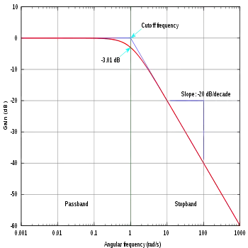

18
The modulus graphic on the bode diagram of a first order high pass or low pass filter, can be approximated by two lines. The point which the two lines meet, when compared to the real line gives us the number of -3db. This point is called the cutoff frequency.
alt text
So, lots of systems are designed to operate in normal conditions until they met the cutoff frequency when they lose at maximum 3db. If you operate with signal above that frequency the signal can be more attenuated.
More info in Wikipedia about continuous low pass filters.
