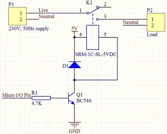

I have a complex circuit, but my problem only relates to one small part.
I have a relay, which is energised by pulling the low side low using an NPN. I would like a pushbutton to operate the transistor (and therefore the relay) for a time (500ms ish) then deactivate it and wait for the next push (ignoring the button if held). I understand how I can achieve this using timers (or a MCU), but I was hoping there might be a more simple and compact solution...
The image shows a simplified schematic of the starting point...
relay transistor and button circuit

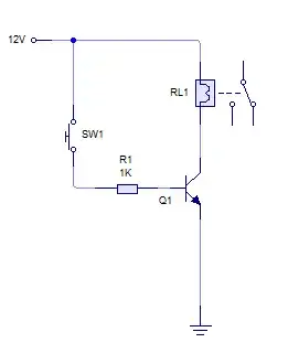

Here is a circuit that will come close to what you want that uses discrete components.
This circuit will have the relay coil in place of the 120 ohm resistor. Remember to add a diode in reverse bias across your relay coil to protect the transistor from over voltage spikes when the transistor goes off.
There are a few things about this that you should be aware of. The relay drive will persist as long as the the switch is until the 100uF capacitor no longer supplies current to the NPN base. This behavior will make the relay turn off even if the switch is held closed for a long time. If the switch is held shorter than the capacitor charging time then the relay will shut off when the switch is released.

    This is definitely what I am looking for, but I think I would struggle to make that smaller than a 555. Looks like a timer is going to be the way forward. OR...someone should produce a physical one-shot pushbutton (if there is already such a thing I can't find it) – Jon May 17 '13 at 12:19
  • @Jon - I agree that you should be looking at a 555 for this application. As you can see from the posting that I made there are some downsizes to the minimal circuit. The capacitor used this way also causes a soft slow turnoff of NPN transistor and could lead to a not so sharp characteristic of the output on/off. In the case of the relay it will drop out OK with this type of drive waveform although the timing could end up being variable. – Michael Karas May 17 '13 at 20:04

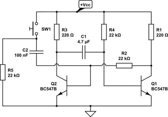

How about a discrete monoflop like this:
Not entirely sure about the sizing of the components (especially R4 and C1) as these are very dependent on the power supply voltage.
  • C2 ensures that pressing the button too long does eventually release the load;
  • Either R3 or R1 can be replaced with an relay (in parallel with a flyback diode, cathode at Vcc);
  • R4×C1 defines the delay time;
  • Either transtor Q1 conducts or Q2;
  • Q1 is conducting while in rest.
