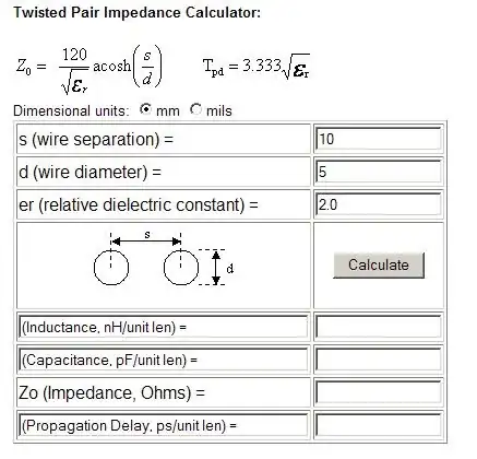

This tells you that to make a higher impedance cable L needs to grow and/or C needs to reduce. One of the methods is to make the actual conductor a smaller diameter whilst keeping the spacing between conductors the same. Or you can make the spacing between conductors bigger. Below is a picture of an on-line calculator: -
Note that the formula given on the page above (Zo) is exactly the same as the one I gave earlier but it uses the more fundamental properties of wires to give L and C. In other words, permeability and permittivity are built into the equations but the 2nd formula explicity lists permittivity because that will be a variable due to the insulation type.
And here is the link to the webpage for the calculator. Please note that there are several calculators on-line so you can double check other ones.
