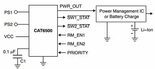

The application described is almost ideally suited to the use of a simultaneous charging and power sourcing IC.
Several other manufacturers offer similar power source selection devices, with various additional features. It would be worthwhile to examine and distill the design requirements to greater detail, then narrow down to a specific part that would best fit such requirements.
