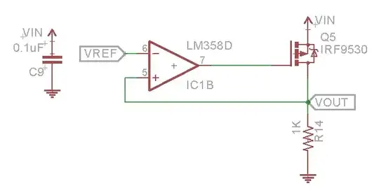

I had the (bad) idea of trying to implement this simple circuit:
Initial circuit idea
The PMOS inside the feedback loop acts as an inverter (more V_gate, less V_out), and that's why the loop closes in the POSITIVE terminal of the opAmp instead of the negative.

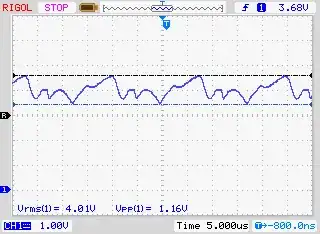

In the lab I set VREF = 5V and VIN = 7V. I should get then 5V at VOUT, but I obtain this out-of-control output VOUT:
Vout

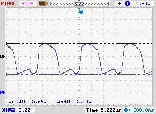

And this is the control signal (output of opAmp, connected to the gate of the MOSFET)
Vg
I find similar behaviors under different VREF, VIN and Rloads. Also note that the output of the opAmp is not saturated to any of the rails.
My assumption is that the gain of the loop is too high for keeping the opAmp in stability.

Your op amp is oscillating because your open-loop gain is larger than 1 at a frequency at which the phase shift is 180°.
The op amp in your circuit is driving an almost entirely capacitive load - the MOSFET's gate.
There are many possible ways to correct this using just a well-placed resistor or a capacitor. It might be best to use a series resistor or a parallel RC shunt, or a feedback RC pair - it all depends on the particular circuit in question.

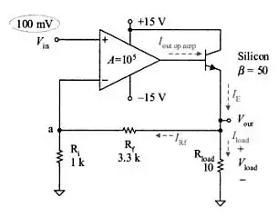

This is really simple - use an N channel FET and have it as a source follower. You can even use a BJT. The one below has gain due to the 3k3 feedback and the 1k to ground from -Vin. If you don't want gain connect the output directly to -Vin and omit the 1k.
A unity gain buffer on the output of an op-amp is either an emitter follower or a source follower. Simple as that - feedback from the emitter/source back to inverting input of the op-amp.
Additionally, because the source/emitter voltage "follows" the op-amps output signal, the gate/base loading effects are minimal hence when using a MOSFET you don't need to worry about gate capacitance.
Think about this sensibly - Analog Devices or TI or MAXIM of LT - their marketing team are not going to wake up one morning and say to their designers - why can't you design an op-amp that allows someone to add a gain stage on it and expect it to be stable. If they did, the designers would say that they'd have to reduce the performance of the op-amp for it to be stable - just how would that op-amp compete in the market against all the op-amps that take the sensible road and keep building what they are good at.
  • Andy, the circuit you have posted is quite equivalent to mine... so I suppose that, if used with a MOSFET, it will have the same problems, am I wrong? – svilches May 16 '13 at 20:49
    It is certainly NOT equivalent - OK my circuit uses a BJT but if instead it used a FET, it would be N channel type with the drain to +15V and the source to the load resistor. Feedback is also to the inverting input on mine. This circuit WORKS for the reasons in my answer. Sure, at 1st glance it looks similar but examine it again and listen to what I've said please. – Andy aka May 16 '13 at 20:53

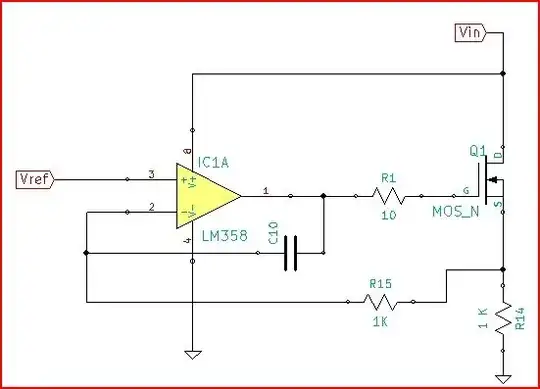

Since the + input of the amp is being used as the negative feedback point, you have complicated things. Normally you would want to use the OpAmp as an integrator with a feedback capacitor from OpAmp output to - input. That way you could control the amplifier crossover point so that the phase loss caused by the FET capacitance could be unimportant or compensated for.
You might start with something like this:
Choose a value for C10 that causes amplifier gain to cross zero gain at 1kHz or less for stability. Using a FET you won't be able to get more than about 3V with any load at the output. In which case you would have to look at using a BJT or higher Vin.

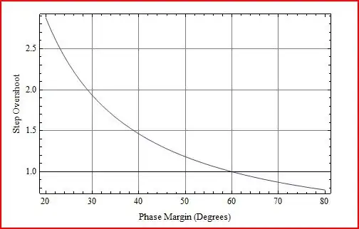

Here is a plot of step overshoot versus open loop phase margin for a unity gain unity feedback amplifier.
Locate 25 degrees of phase margin in the plot and see that it matches an overshoot of about 2.3. For this source follower circuit using a IRF520, you would expect a step input of 100mV at the reference voltage to cause an overshoot of 230mV on top of its 100mV response. That overshoot would turn into ringing at about 500kHz for an extended period. A current pulse on the output would have a similar effect of big overshoot followed by ringing at about 500kHz. This would be unacceptably lousy performance for most people.

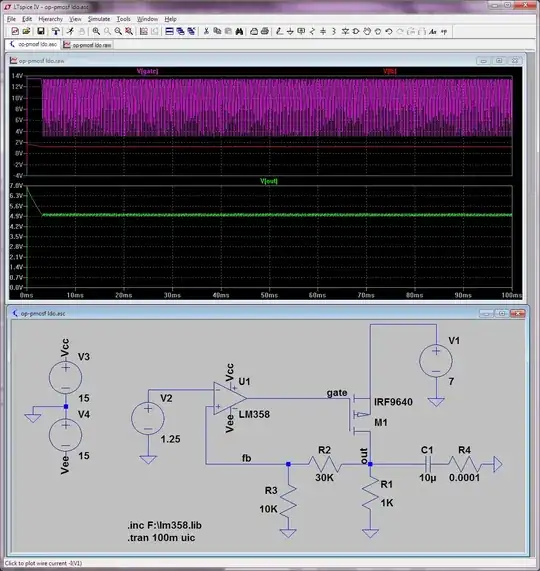

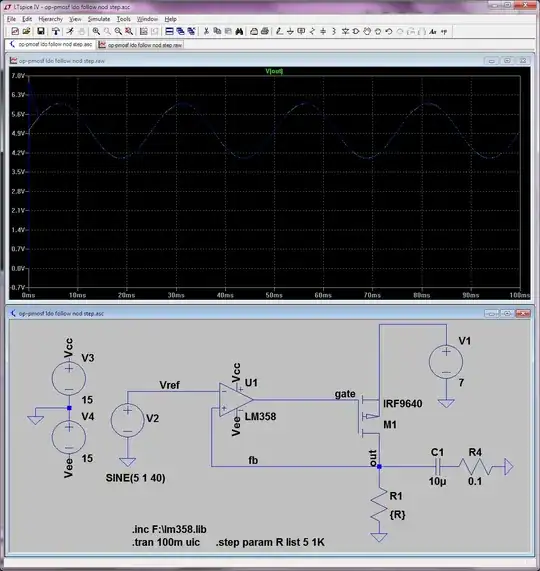

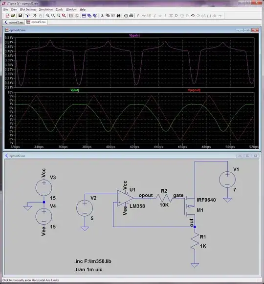

@LvW: I need to think a bit more about what exactly happens but see updated graph with Vgate plotted as well. Clearly it never reaches 5V so the opamp is never seeing actual negative feedback as this design purportedly does. So the opamp works like a comparator basically. There's also some phase shift between these two signals, but I'm not convinced that's the cause of the oscillation, rather I think it's "by design". I've tried adding some big (1K, even 10K) resistor on the gate, and it still oscillates the same.

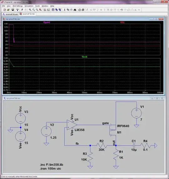

Basically what you're trying to do is design a PMOS LDO! But you're doing it fairly wrong. You need to compensate it with a bypass cap of the right-ish size and ESR! Also, a PMOS LDO would take the feedback through a voltage divider. Here's my amateurish LDO design:
As usual with PMOS LDOs, the output cap ESR is critical and needs to be in a certain band. Look what happens if I lower it, for instance; starts to oscillate:
If ESR is too high, you're again in trouble; well for this load it does have to get pretty high before it oscillates on the other side of the safe band:
Actually, the only critical element in there is that compensation cap. A 10uF one with 0.1ohm ESR appears to work for a fairly large load range from 1K down to 5 ohms (which would give you the 1A output you wanted):
You'd get some bandwidth limitation from this cap of course.

  • Positive feedback? I think, the FET acts as a common source stage with inverting characteristics, does it not? – LvW Nov 25 '15 at 13:26

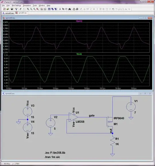

  • @LvW: see updated graph and paragraph added. – Fizz Nov 25 '15 at 13:35
  • @LvW: I sorta figured it out. It was not a terrible idea, but was reinventing a certain PMOS LDO wheel and not doing it very well. – Fizz Nov 25 '15 at 14:46
