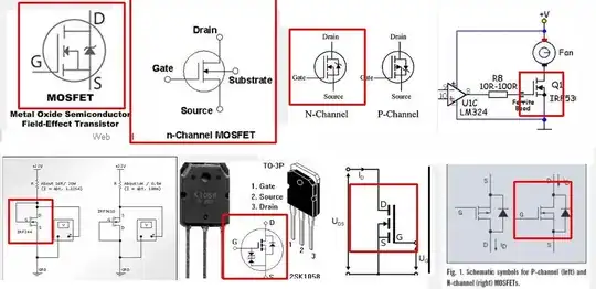

I've been on this site now a couple of months and I notice various symbols used for MOSFETs. What is the preferred symbol for an N Channel MOSFET and why?
  • I doubt you'll get an objective answer to this question, since there are multiple opinions on the matter and (to my knowledge) no international standards on component symbols. (The fact that you've seen multiple symbols here should be a hint that 'anything goes'.) – Adam Lawrence May 14 '13 at 21:04
  • You should use the symbol which is pertinent. If you're really making a point about an enhancement device your should really use one with a dotted channel - for example. But for the most part, it doesn't really matter. – placeholder May 14 '13 at 21:08
  • http://chat.stackexchange.com/transcript/message/9424690#9424690 – jippie May 14 '13 at 21:11
    **There is an international standard** for these symbols, whether anyone likes it or not. I'm guessing that many readers will not. See answer below. – Joe Hass Dec 22 '13 at 12:25
  • When in doubt pick the symbol used in the manufacturer's datasheet. – Noah Spurrier Sep 28 '14 at 19:12

Jippie's example shows the rogue version.
[Note: See below - this is in fact intended to be a P Channel sysmbol].
Truly horrible. I'd have to wonder if this was a P Channel symbol or an N Channel one.
Even the discussion it is taken from has people expressing uncertainty re arrow direction. As shown IF that is an N Channel then it is implying body diode polarity and NOT current flow in source.

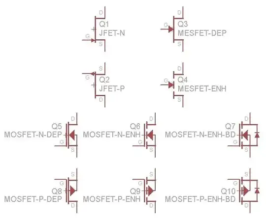

I have had to create my own Eagle library with various parts to represent different kinds of FETs:
FET Symbols
These includes JFETS, MESFETS, and MOSFETs in depletion mode, enhancement mode, and enhancement bode with a body diode. Notice the location of the gate relative to the body for P and N channels, the solid line for depletion mode, the dotted line for enhancement mode, and the additional body diode.
However, there are still many other types of MOSFETs that could be represented differently, such as those with dual gates or showing the body (substrate) connection when it is not shorted to the source. Drawing the circle around the FET is also common, but I have chose not to do it here because it clutters up the schematic and makes the component values difficult to read. Occasionally, you will see the arrow pointing in the opposite direction at the source - this typically means enhancement mode with no bulk.
Kurt E. Clothier
  • 4,419
    Why do you have zener bars on the body diodes for the ENH-BD devices? – James Waldby - jwpat7 Dec 31 '16 at 05:04
  • Good catch. That particular part used Schottky diodes, and I can only imagine it was a rendering error when I made the image. Although, realistically, it shouldn't have any bars at all for most body diodes. I'll fix that when I have a minute... – Kurt E. Clothier Jan 03 '17 at 00:00

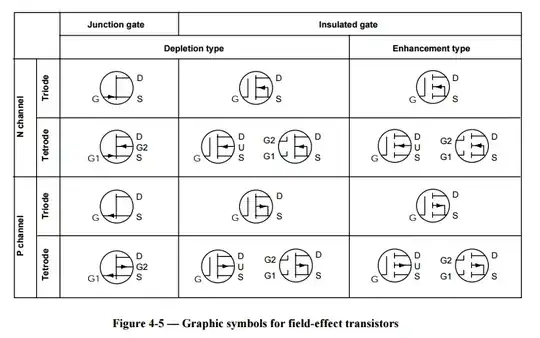

Yes, Virginia, there is an accepted, published international standard for these symbols. It is IEEE Standard 315/ANSI Y32.2/CSA Z99 and it is mandatory for the US DoD. The standard is intended to be compatible with approved recommendations of the International Electrotechnical Commission. The standard is very detailed and lengthy so I'll show just a few examples.
This is an enhancement-mode, four-terminal, NMOS transistor. Note that the gate terminal shall be drawn as an L-shape with the corner in the L adjacent to the preferred-source terminal. The arrowhead pointing inward at the bulk/body terminal indicates that the body is P-type (and so the source and drain are N-type). The vertical line segments for the drain, bulk, and source connections are disconnected to show that the transistor is an enhancement-mode device.
Here is the same symbol, except for a depletion-mode transistor. Note that the vertical segments for the drain, bulk, and source are continuous.
The standard allows for an internal connection between the source and bulk, as shown in this depletion-mode NMOS.

    In practice IEEE is more US than international. I'd be interested to find out if these have trickled into some IEC standard. IEC has some joint committees with ANSI, so they might have. [IEC 60617](http://std.iec.ch/iec60617) is probably where they are. – Fizz Jan 01 '15 at 19:57
Here's the relevant page from CEI EN 60617-5:1997, which is basically the Italian incorporation of the IEC 60617 standard. Other than the fact that they call MOSFETs IGFETs, it's basically using the same symbols as the IEEE standard, but sans circles.enter image description here
Note that the dot grid is not part of the symbols. It's only used in this standard to indicate how big the symbols are to be drawn relative to other symbols in the standard.
The (common) p-channel MOSFET with substrate internally connected doesn't appear to have a symbol in this version of the standard, i.e. the standard is lacking a p-channel version of symbol 05-05-14. As stefanct points out in a comment below, this list is just a list of examples of how standard's elements are to be combined, so the non-listed variants are composed by analogous rules.
