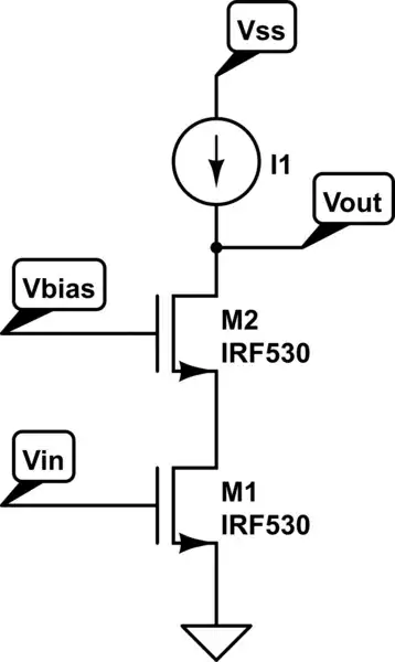

The miller effect arises in situations from a connecting capacitance across two nodes that that have an inverting voltage gain/relationship between them. it doesn't have to be in transistors either, but in MOSFET's you have \$C_{GD}\$. How this is traditionally solved is to cascode the amplifier by isolating the offending capacitance so it doesn't appear across the gain stage. The dual gate Mosfet is basically a cascode stage with the cascode transistor built in (this has a secondary effect, see below), you just have to bias the the transistors so that they are in the active regime. M1 = amplifier, M2 = cascode
The amplifer transistor converts the input voltage in the output current and the cascode transistor simply transfers this current to the output load. the output is on the drain of the cascode and the input is on the gate of the amplifier transistor. There is no capacitance across the two nodes, the miller effect is greatly reduced.

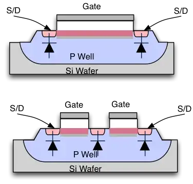

An interesting effect from manufacturing comes into play. The upper device is a longer gate device and the lower is a dual gate device. The S/D implant to channel capacitance tends to be lower than the S/D to isolation edge capacitance (the S/D's on the outer edge) so the S/D in between the gates will tend to have a lower capacitance that if you were to have designed the circuit using two separate transistors in a cascode configuration (and obviously they take up less area). This means that the \$C_{SB}\$ capacitance is less as well making for a higher speed circuit, here SB = Source to Bulk (AKA well).

  • 'STI edge capacitance' Not sure where to look. Same for Csb – jippie May 14 '13 at 20:41
  • edited to explain terms. STI - Shallow Trench Isolation – placeholder May 14 '13 at 20:57
  • This speaks for that the capacitance in the drain1/source2 connection point is smaller for a dual-gate compared to two single-gate transistors. Will that give an improvement in bandwidth, though? (compared to two single-gate transistors) Will the bandwidth not be dominated by the (larger) capacitance at the output of the cascode for both the case of a dual-gate transistor and two single-gate transistors? – nijoakim Jun 03 '22 at 08:08
A dual-gate MOSFET can be used as a cascode amplifier — see Figure 1 in the Wikipedia article. By holding the "upper" gate at a fixed voltage, the effective drain voltage that the lower gate sees is also fixed, eliminating the effects of capacitive coupling to the lower gate.

MOSFET cascode: -
Because Q1 has very little AC signal on its source (due to the gate being decoupled), miller effect on Q2 (drain-to-gate) is greatly reduced. Q1 provides the voltage amplification due to it being injected (via its source) with AC current from Q1's drain. Q1 doesn't suffer from miller effect because its gate is decoupled.
Two MOSFETs in a row built on the same substrate is fairly trivial and this forms the dual gate MOSFET which relates to the cascode amp above, and the tetrode valve (which has control and screen gates doing the same thing).
  • Ported your schematic to circuitlab for better readability, but are these supposed to be P channel MOSFETs? – jippie May 14 '13 at 20:27
  • @jippie I know you meant well but i don't like that circuit - I don't understand the symbol for the N channel FET - it's not what I'm used to seeing so if you wouldn't mind could you please return the original circuit and I'll modify it tomorrow - BTW I can't use the circuit editor on internet explorer, it just will not work on my home PC. If you can't return it back let me know and I'll re-insert it then tomorrow I'll upgrade it to make the n channel device clearer – Andy aka May 14 '13 at 20:32
  • No problem, I commented it back to the original form. I'll see what I did when you edit the question. `` – jippie May 14 '13 at 20:36
  • @jippie cheers - might have to ask a question about mosfet symbols on the strength of this – Andy aka May 14 '13 at 20:46
