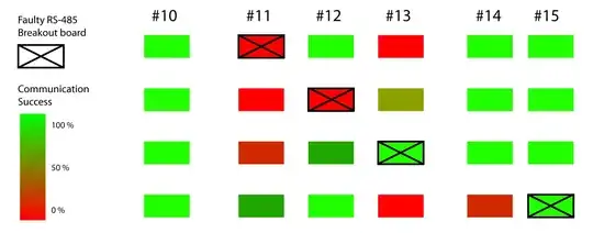

The image below shows what the transmission success analysis of what happens when the same faulty transceiver is inserted at different positions in the network bus. Sometimes the transceivers own transmission success is at 0% (at position #11 or #12), sometimes it is at 100% (at #13 or #15). Sometimes its neighboring devices are at 0% or 100% or at values in between. Note that these results are constant, and not fluctuating.
Faulty transceiver and its effect on transmission success rate
I am hoping someone can see a pattern in these results, or has an idea of what part of the transceiver could have been damaged. Maybe someone has experienced similar problems with RS-485 networks and can point me in some directions. With this post here i am not trying to figure out what could have caused the damage to the transceiver, but trying to understand how that damage effects the whole network. With the aim of being able to diagnose it faster in the future.

    An obvious problem with this board is the lack of a pull-down resistor to default the transmit enable (DE on the chip, RTS on the board) to disabled until explicitly driven by running software. You should probably add this when you wire it up. Otherwise, just one of these lacking running software actively controlling it can jam the entire bus. – Chris Stratton Aug 16 '18 at 12:44
I think to properly diagnose this you will need to eavesdrop with something like a FTDI rs458 converter, along with an oscilloscope. With the scope you can see when a transceiver grabs and releases the line. You may have to manually poll each node and review each response. If you can pinpoint the module that is holding the line "down", see if its corresponding enable pin is actually held high. If the line is not being held down, it could mean that two nodes are attempting to reply at once(atmega firmware issue).
Be sure that you have terminated the system with two 120 ohm resistors per repeater instructions.
