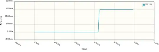

Results from simulation, where the input ramps from 0V to 8V over the period of a second:
Input Voltage:
Input Voltage
LED Current:
LED CUrrent
The LED goes from zero to fully on over a range of something like 80 mV.
Zener diode D1 biases the input so that the turn on takes place at around 5V.
Note that only about 150 microamps of current are required across R1 to develop 0.7V across Q2's EB junction. That small amount of current does not require the BE junction of Q1 to be fully turned on! This is why the Zener value isn't based on 5V - 0.7V. From the simulation, the transition occurs between 5.12V and 5.2V, and not starting at 5.3V as the approximate junction model would suggest. Higher values of R1 do not significantly improve the upper 5.2V voltage, but degrade the soft turn on voltage. The next available lower Zener model in the simulator is a 4.3V unit, which leads to a turn on that falls short of 5V. Raising that toward 5V requires lower values of R1, which cause Q1 to pull as much current as Q2.
