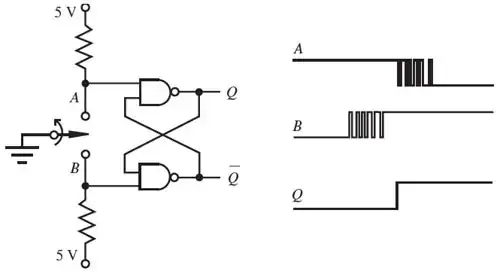

If you really want a hardware solution I second the SR flip-flop solution mentioned in the article as the technically best solution:
debounce circuit
The flip-flop can be constructed with a dual NAND gate, which is available in a small VSSOP8 package, for instance. The major drawback of this solution is that you need a SPDT pushbutton, where SPST is much more commonly available.
