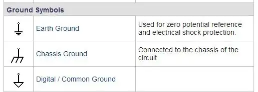

From this key it seems that various parts of the above circuit are to be tied to chassis ground and not to (say) digital/common/signal/control/logic ground.
symbol chart
Why specify chassis ground? Am I wrong in interpreting that as the metal part of an enclosure which is (usually) tied to earth through the mains electrical connection for safety purposes.
I have looked at similar questions here† but am still puzzled by the choice of symbols on the example circuit.
Why are these particular symbols used in this circuit diagram?

  • Chassis Ground need not be connected to building earthing. – Anindo Ghosh May 02 '13 at 09:50
  • @AnindoGhosh: OK but why is R2 tied to building earthing and not to chassis ground? – RedGrittyBrick May 02 '13 at 09:54
  • That symbol is not Building Earthing, it is circuit reference ground. That too need not be connected to building earthing, it's just what any voltage in the circuit is referenced against. Why they choose to connect to it I haven't examined, I'll look at the schematic later - that's why I am not writing up an answer now. – Anindo Ghosh May 02 '13 at 09:56

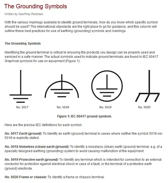

IEC60417 is the supposed standard to which symbols in Europe (as a minimum?) should adhere to but I reckon there is no legal obligation except for protective earth (PE). Here's a picture: -
Notice #5019 - this has to be used when a protective earth is specified and I've seen them on various boxes and bits of equipment to signify just that - it is the protective earth connection.
The questioner shows the "earth ground" symbol for protective earth and this I dispute on behalf of the whole of the EU !!! But who is to say what "region" the questioner's symbols apply to and it wouldn't surprise me if the bureaucrats have changed their mind on things again.
If you use the PE symbol then that is what it is and has to be BUT, anything goes for the other symbols. As I implied in my comment, to avoid power-ground noise upsetting the feedback and regulation of this device (and most other switching regulators should they have separate pins) different symbols are used to help the reader understand important areas to be considered in the design.
  • [According to iso.org](https://www.iso.org/obp/ui/#iso:pub:PUB400008:en): "This collection includes both ISO and IEC graphical symbols that can be placed **on equipment** to indicate how to use it correctly and safely." So this is not truly relevant. – jaskij May 04 '21 at 20:04
