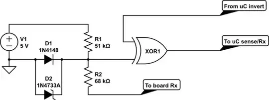

Take this SR05 for example. The data sheet explains that you can use it with or without a reference voltage at pin 4. So why have the steering diodes at all for ESD protection? Is it to ensure that the TVS only receives bias when the voltage at pin 2 and 3 are greater than or equal to the breakdown voltage of the TVS?

Also, the apparent "full wave bridge" arrangement of the two-line array (as pictured), can be used directly as a bidirectional clamp as well; ±Vclamp is one TVS plus two diode drops. This may be handy when clamping differential voltages (e.g. Ethernet on the media side).

The steering diodes form a bridge rectifier with the TVS on the rectified output hence, this makes the TVS bi-directional (if you want to use it that way).

Picture? Trying to understand what rectified output you're talking about and how it's bi-directional. – BobaJFET Aug 24 '23 at 20:50
1Look at the 1st picture in your question = bridge rectifier feeding a TVS @BobaJFET – Andy aka Aug 24 '23 at 21:24
