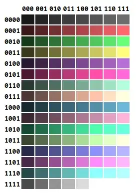

That would give me following colors:
BBBCCCC colors
Not very artistic, but predictable and (I think) usable.

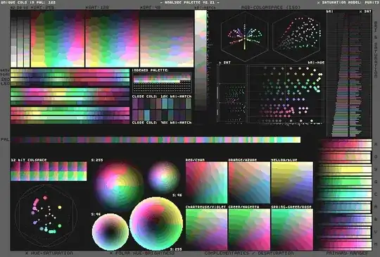

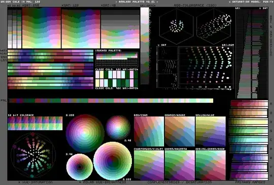

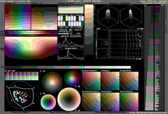

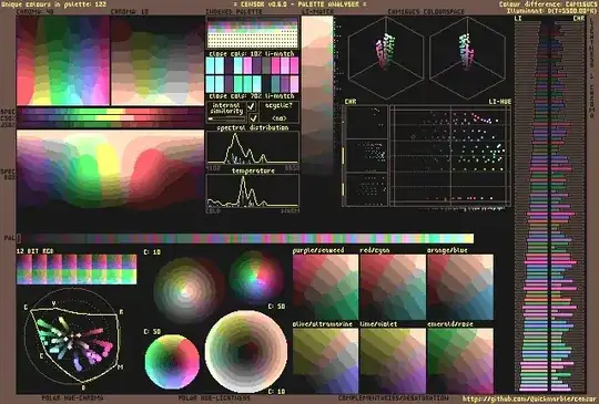

I did palette analysis of this color creation method and it is obvious that brightening by R/G/B amplification is sub-optimal (conical color-space coverage).
dawnbringer-palette-analysis censor-palette-analysis
