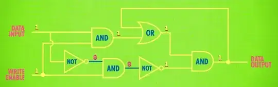

Look again at your diagram. First of all, if the Q output is low, the K input has no effect at all, since it is disabled by the feedback. The next state depends only on the J input: if it goes high with sufficient setup time before the falling edge of the clock, the output will go high; otherwise, it will stay the same. Nothing is indeterminate.
The state of the master latch is transferred to the slave latch on the high-to-low transition of the clock. But note that because of the delay of the inverter, the inputs to the master latch are disabled before the inputs to the slave latch are enabled.
On the low-to-high transition of the clock, the master inputs are enabled before the slave inputs are disabled, but this delay is still shorter than the time it would take for any change on the J/K inputs to propagate through two levels of gates in the master latch to the slave inputs.
