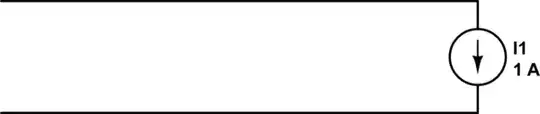

Example of first stage design
There is a design process for a similar amplifier found here at the EESE site that includes the following schematic:
This is about how I would approach a first stage design using low noise BJTs (like the BC549 and BC559), except that the above design isn't just a first stage, wasn't designed for low noise, and is instead designed to directly drive a speaker.
There's a comment there, from G36, saying that the above design is similar to one by John Linsley Hood, dating back to this 1969 article (now preserved at Elliot's site).
This brings me to the point. There is an excellent pair of articles at Elliot Sound Products:
That 2nd article (see Figure 4 there) provides a design extremely similar to what I was thinking about, above. In fact, it also uses the same \$9\:\text{V}\$ battery and specifies the same \$10\:\text{k}\Omega\$ resistor!
(Once you decide on the battery, the resistor mostly just falls out from that. So we reached the same place likely for similar reasons.)
Elliot's design also selects a current source driven class-A design (which makes more sense that going for class-AB, since accuracy is important and power isn't the issue.)
We are essentially on a similar page, even down to the expected gain region. I would guess that any other good quality design will fit this pattern, too.
I've redrawn it in a way I prefer for understanding it. And I've replaced his output capacitors as this will be feeding into the next stage and I just wanted to test it. Click on the image to make it larger and more readable:
I've also included an electret simulation of my own in the lower left corner, for testing purposes. (And the obvious \$9\:\text{V}\$ battery source simulation, as well.)
The top graph shows the loaded microphone output, which is about \$2.5\:{\text{mV}_\text{RMS}}\$. Unloaded, this would be closer to \$2.8\:{\text{mV}_\text{RMS}}\$. But the amplifier will load it down a little.
The bottom graph shows the unloaded output of the amplifier stage. (I used a \$10\:\text{M}\Omega\$ resistor, which is essentially no load.) This is about \$10.6\:{\text{mV}_\text{RMS}}\$. So the gain is about \$+12.5\:\text{dB}\$.
I'd probably add a \$47\:\text{pF}\$ capacitor between \$Q_4\$'s collector and base to roll off the high end. But that's all I'd probably do.
I think this confirms the advice I gave you, earlier.
