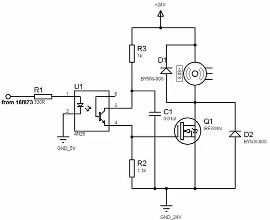

I'm working on a speed control circuit for a brushed dc motor (24v, 500rpm, 2A, 4kgcm).
The main components that I plan to use are PIC16f873, 4n25 optocoupler, IRFZ44N MOSFET, BY 500 - 800 diode(for free wheeling).
  • What is the criteria behind choosing the PWM frequency?
  • What are the effects of very high & very low PWM frequencies on the system?
  • What are the drawbacks and improvements to be made in the hardware provided here?
Schematic

As for your circuit, my biggest concern is how slowly Q1 will be driven. Opto-isolators are notoriously slow (relative to most other components like individual transistors), especially when turning off. You only have R2 (although I can read its value) pulling down on the FET gate to turn it off. That's going to be slow. That may be OK if you can tolerate a slow PWM frequency, considering all the other trade-offs I mentioned above.
You might consider putting a PIC on the motor side of the opto. You can communicate digitally with that PIC via a UART interface or something that doesn't have to run at the PWM frequency. That PIC then generates the appropriate PWM locally and drives Q1 hard on and off with extra circuitry for that purpose. That way the high speed signals and fast edges don't go across a opto isolator.

  • @olin Lathrop , what if I replace opto coupler with a suitable transistor to drive mosfet in order to achieve the higher switching speed. – raforanz Apr 30 '13 at 16:42
    @rafo: Then you don't have isolation anymore. If you don't actually need isolation, then what was the point of the opto in the first place? – Olin Lathrop Apr 30 '13 at 17:14
  • I just thought of an isolation since it is dealing with a motor. But you said it cannot handle high frequencies. – raforanz May 02 '13 at 04:52

I would recommend opto-isolated gate driver like this: https://www.fairchildsemi.com/datasheets/FO/FOD3182.pdf I've used something like this in class D amplifier at ~200kHz switching frequency.
