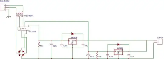

For designing a low side non-sync buck regulator I am looking for MOSFET(s) that can provide low overall power loss. Conditions would be 60V to 48V, 10A, 600 kHz (worst case), 1 Ohm source and 0.35 Ohm sink gate driver. Schematic would be as shown below, although without a LED load.
enter image description here [Reference image from https://shadyelectronics.com/low-side-buck-step-down-converter/]
For this I was using the Cross reference comparison tool by EPC that provides the various power loss for a MOSFET for switching conditions specified. If we take a potential MOSFET such as FDD86110, we see that the diode reverse recovery loss is much higher than other losses. This is validated by calculation of loss by P=Vin×Qrr×Fsw.

  • The DFLS2100-7 diode will smoke when working with a load of 20 amps. I'm trying to figure out why you posted that schematic image given that it clearly has a known problem with the output being connected to an LED. – Andy aka Aug 01 '23 at 08:33
  • I have mentioned in the question that it is a reference schematic and the load isn't a LED. – EarthLord Aug 01 '23 at 09:19
    In what way is the MOSFET being reverse biased? – Tim Williams Aug 01 '23 at 11:14
  • Oh, the MOSFET here won't have diode reverse recovery loss as its similar to the top MOSFET in a normal buck. The current through the MOSFET won't flow in the same direction as the body diode's forward direction. Thanks Tim. – EarthLord Aug 02 '23 at 06:07
