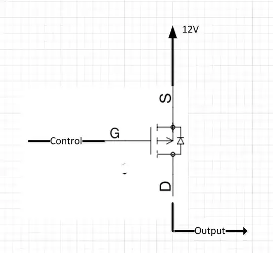

In the picture shown, can "Output" be controlled to be 0V or 12V based on "Control"?
Will be Drain and Source the way it is connected be a problem?

The transistor shown is a P-channel MOSFET acting as a "high-side switch". More commonly, an N-channel MOSFET low-side switch is used, but what you have will work as long once you add something to the drain such as in this image of P-Channel MOSFET switch from http://www.electronics-tutorials.ws/transistor/tran_7.html:
P-Fet Switch
When the control goes "HI" the MOSFET switch is "OFF." When the control goes "LO" the MOSFET acts as a switch, essentially shorting the drain and source. While this is not entirely true, it is a close approximation as long as the transistor is fully saturated. So the schematic you have shown can be used to switch 12V to something, but it will not connect the output to 0V unless a pull down resistor is used as shown in the above image.

You are using a P-channel MOSFET as a high side switch. That's fine. The direction you have it wired in is fine.
As long as "Control" is 12V or higher, the switch will be "off." If it drops below 10V or so, the MOSFET will start conducting (exactly how much it needs to drop depends on the Vgs-threshold of the device.)
Typically, to use a logic-level control (0-5V or 0-3.3V) you will use a pull-up resistor from gate to source (say, 1 kOhm or so) and a small-signal N-channel MOSFET between the gate and ground. When the signal goes into the gate of the smaller N-channel MOSFET, it will open, and pull the gate of the P-channel to ground, and thus the P-channel will start conducting in the blocked direction. (It always conducts the other direction, so don't switch the terminals!)
Once the gate of the small-signal N-channel goes to ground again, it will stop conducting; input voltage will pull the gate of the P-channel MOSFET up, and the P-channel will stop conducting.
Somebody asked for a schematic for the circuit for controlling this P-channel MOSFET with logic-level inputs, so I edited to add this:
I couldn't figure out how to change the names of the components -- you typically want a signal transistor like a BS170 for the bottom N-channel switcher. You can also tune the resistors for your preferred trade-off of current consumption vs fast switching (the current values are fairly aggressive for fast switching; 10 kOhm will often work fine) The ability of the output to be driven to 0V depends on the load. If the load will by itself pull the output down to 0V, then yes, this will be able to switch the output between 0V and 12V. If the load is purely capacitive, then you will need a pull-down resistor between output and ground, like Kurt shows.
An N-channel MOSFET, as Kurt suggests, only works if it's either on the low end, or if you use a bootstrap/charge-pump circuit to boost the voltage into the gate above the 12V source voltage. N-channel as "high side switch" is only used if you make lots of your circuit (so the cost of P-channel matters) or the circuit is very sensitive to losses (so the lower Rdson of N-channels matters.)
Yes, this will produce 12V when the control line is "low" and if you had a resistor to 0V from the drain, the output would be 0V when the control line is high (12V).
The control line needs to have, as a minimum 12V to turn the FET off (thus letting the resistor to ground pull the output to 0V), and somewhere between 11V and 6V (typical values and dependent on the FET) to turn the FET on.
No this won't be a problem
