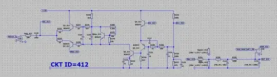

Apologies for the delay, posting here now the answer developed in-house (by myself) that was accepted based on LTspice sims, for implementation at a later date. Here is the overall circuit below, made of "jelly-bean" parts:
overall circuit
Brief description of the circuit:
The input voltage is converted to a current source (10V peak -> 500uA peak), this current flows into a two-transistor common-base stage (Q1_412, Q2_412) that directs the current into separate collector circuits based on polarity. The lower output (Q2) is used for the output since it is referenced to 0V (gnd). The upper output (Q1) is not used, but could be directed to the output (Q2 collector) via an additional current mirror to form a full-wave precision rectifier if so desired (not required in my case). Image below shows input signal and Q1, Q2, please ignore R276:
input and Q1, Q2, please ignore R276
The collector current of Q2 is converted to a voltage by resistor [Rgain_412], the value of which is set to the ideal value times a correction factor; viz:
(20k * 1.571) being the ideal value to convert 10V peak half-sine (500uA peak) to 5Vdc average;
and 1.019 being the correction factor to trim the output to 5.00V+/-20mV at 100% input due to the non-ideal transfer function of the circuit at the AM carrier of 1MHz. This is then filtered by a two-stage RC filter to get the desired ripple and step response.
(Aside: this correction factor suggests the gain reduction at carrier of 1MHz is just 2%.)
Image below shows the output filter:
output filter

Alternative Circuit:
The circuit below is an alternative with almost identical performance, the main change is that the error amplifier is now implemented as a differential pair. C97 & C158 around Q3_414 can be ignored, these are placeholders for bandwidth limiting caps in case they are needed to ensure stability for the real-world production circuit.
Compared to the previous circuit:
  1. Total number of transistors is unchanged.
  2. The bias network for node [EA+_414] was changed so that Q2_414 emitter voltage is the same as for the previous circuit (~8V).
  3. Bias current for the diff pair is set by [Rdiffbias_414] and was selected so both circuits present the same current drain on the +12V supply at no signal.
  4. Resistor [RQ3c_414] was selected so collector currents of the diff pair were balanced.
  5. Gain resistor [Rgain_414] needed a slight adjustment to give the required output of 5.00V+/-20mV at 100% signal.
  6. Gain of this new error amp is about half that of previous error amp (voltage across its inputs is 26mVp-p vs 11mVp-p for previous error amp, for same Vout of ~250mVp-p), but this has a negligible effect on overall performance of the detector.
Image below shows the complete alternative circuit: enter image description here
Image below shows the error amplifier section: enter image description here
Images below show the error amplifier input voltage (EA- wrt EA+) at 100% signal (just before the modulating signal drops to 0) for both circuits: enter image description here
Edit 15-Aug-2023: Frequency Response
Just for completeness, adding here the sim results showing the output of the peak detector as the carrier frequency is increased. The output is down by 10% from ideal at F=5.5MHz. The results suggest this peak detector is usable with input signals up to about 5MHz, depending on acceptable levels of frequency-dependant error.
If the input frequency is kept within a narrow range, then a compensation factor can be applied to the output (via [Rgain]), extending the usable frequency out to 10MHz or possibly even 20MHz; but input sensitivity may be affected.
Image below shows the response as input frequency is increased. The input to the peak detector is a 10Vpeak sinewave generated by a VCO, the frequency starts at ~10kHz and starts to ramp up from T=100us.
Upper chart: VCO input, 1V==1MHz.
Lower chart: purple trace=output (ignore red and green).
