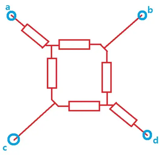

I think the problem might lie in what shape the square of resistors converts to. For instance consider your original square and add two imaginary resistors like this: -
Then if you did two lots of delta to star conversion you'd get this: -
And, even though the two imaginary resistors I added will make some values simplified in the conversion, I doubt that you'd get an equivalent shape to your original X-shape: -
I suspect this is impossible. Look at this example. enter image description here
Zero Ohms could really be 1Ω or any small value, and ∞Ω any very large value. The two top corners, the ones A attaches to, are basically shorted, and likewise the two bottom corners. But the top left and bottom left don't communicate at all, no current flow. Likewise on the right side.
In the squared-up wye network, or star network if we can call it that, how can we have current flow between the two top terminals, and also between the bottom two (pink arrows), yet not allow any current flow between the two left, or the two right, terminals (green X'd off arrows)? There is one central node that all branches attach to, marked !? that makes this expanded delta-wye transform impossible.
If there is some sort of topology transform possible between a ring of elements (polygon) and something else, that something else will need more than one internal node.
