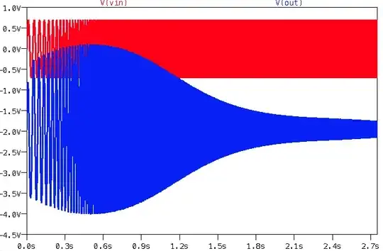

  • Crystals are very high Q and so if the power does not rise quickly to give them a hearty whack they may take some time to slowly increase and then stabilize at full amplitude, so you may wish to have a longer SUT just in case. That's (usually) unnecessary with (relatively) low-Q ceramic resonators. Other than the startup delay time, the choices of BOD and oscillator type is not interrelated. – Spehro Pefhany Jul 07 '23 at 16:56
