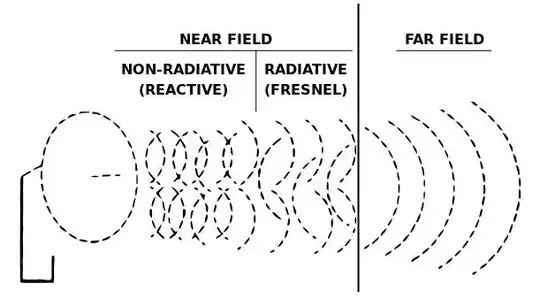

Here's a picture that might help: - enter image description here
The picture shows a dish antenna but quite simply it is an antenna just like a piece of wire or a trace on a PCB BUT remember, the dish is designed to emit efficiently at a particular frequency whereas tracks and wires may "resonate" at several wavelengths.
Close to the wire/dish/trace/antenna, electric fields and magnetic fields are produced that store energy just like inductors and capacitors do - these fields (close to the antenna) do not radiate very far. Notice in the picture, the dotted lines overlap and intersect each other - the picture is trying to represent an "incompatibility" between E and M fields. I'm looking for the correct word to use here... I thought "incoherency" but maybe not, maybe there is a better word rather than incompatibility.
As distance increases towards the equivalent of about 1 x wavelength, if the antenna is efficient, the E and M parts start to "align" in time i.e. their amplitudes rise and fall together. Before that (in the near field) there is a cacophony of misalignment which is mainly due to the L and C of the antenna - the E and M fields are not aligned in time and in fact, the E and M fields around the antenna can be misaligned seemingly almost haphazardly.
As distance increases AND if the antenna is good at doing its job, in what is known as the far-field, proper EM waves are produced. It's still a very mysterious phenomena to me!
