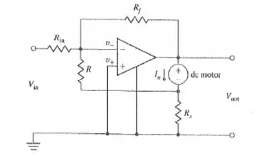

The one-line diagram is as below,and a three-phase fault has occurred in the bus 1,now find the fault current enter image description here
