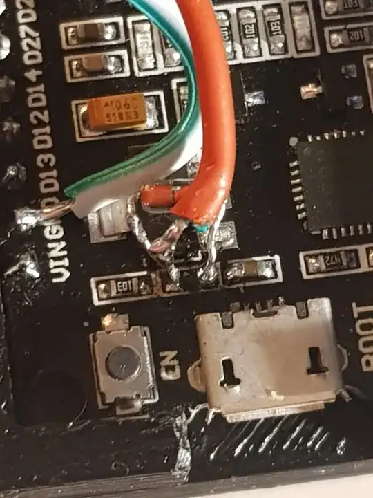

Well... learned this the hard way. Max 1A
ESP32DevkitV1 with ghetto repaired diode
