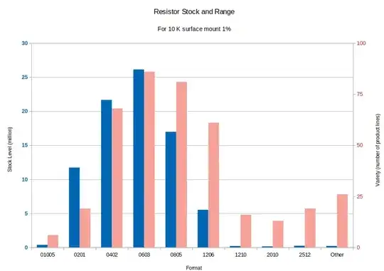

Survey
I took a survey at a major US distributor for its selection of 10 K SMD resistors with 1% tolerance, to see what sizes it expects to sell.
It had a total of approx 80 million parts in stock and about 400 product lines, with 97% in the range 50 mW to 250 mW; the most common were 100 mW (30m parts, 80 varieties) The highest level of stock was for the size 0603 (all sizes here are inches), with about 30% of 10K 1% SMD in this size, and ~90 different product lines. The highest stocked individual part numbers were 0603 (100 mW) with 12 million in stock, 0805 (125 mW, 7.7m), 0402 (62.5 mW, 6.4m). 0201 and 1206 were about 3m each, at 50 and 250 mW respectively. 0201 was 200 ppm/deg C, all the other 100. All of these were the same price, about USD 4 per 1000.
Thus, after checking whether you have any special requirements for power or anything else, most designers appear to plump for 0603. My inference (from stock levels vs number of product lines) is that we're seeing a shift away from 0805 and an increase in 0402. The high level of choice and low stock levels for the larger sizes (1210 and up) suggests they have niche and or obsolete purposes.
