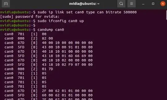

To see what happens in CAN I'm using candump can0 in a terminal and I can see every message of the comunication, in the next image you can see a part of the comunication: Image candump
As you can see in the image, the line can0 701 [1] 05 is the line of the producers heartbeat that appears every second, as configured. The other lines are for CAN initialization (NMT messages) and valve opening and clossing.

I've added comments next to the CANopen dump output (next time please add the dump in text form).
Red comment: Master (node 1)
Yellow comment: NMT (most probably from the master)
Green comment: Slave (node 125)
As you can see, it's not the slave (node 125) that's sending the bootup and heartbeat messages, but the master (node 1). There is nothing wrong with the master sending heartbeat messages. But in your case you said you wanted the slave to be the heartbeat producer and the master to be the heartbeat consumer.
In order to configure the slave (node 125) as heartbeat producer, yo need to configure 0x1017.0 accordingly:
Write 0x1017.0 = 1000: 67D [8] 2B 17 10 00 E8 03 00 00
This will let node 125 send heartbeat messages in a 1 second interval.
The heartbeat message produced by node 125 should look something like this: 77D [1] 05
The COB-ID should be 0x700 + NodeID; byte 1 indicates the NMT state.
