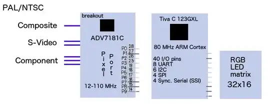

I am trying to program a low-powered Bluetooth Low-Energy sensor using an nrf52810 microcontroller. I am trying to minimize power consumption when the sensor is idle. I have created a minimum code example to demonstrate my issue. This code simply enables the DCDC regulator and the external high-frequency crystal, then enters idle state with WFI. I have also uploaded the circuit schematic as a PDF in that same repository.
Circuit schematic of my device. See the above-linked PDF for higher resolution.
