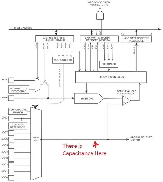

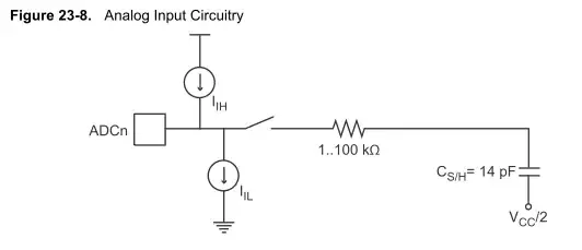

Basically, the input connections to the ADC inside the chip, after the multiplexer have some capacitance. If you look at the equivalent circuit for the ATmega ADC input:
You can see what the input looks like.
The problem with high source impedances arises when you are switching the input multiplexer from one pin to another. If you have two inputs, one at 0.5V and one at 4.5V, when you switch from one to the other, the input has to charge (or discharge) that 14 pF capacitor.
If the signal source is very high impedance, having to charge the capacitor may cause the input voltage to drop temporarily. If the ADC converts on the input while is is still charging the capacitor, you will get an incorrect value.
This can probably be dealt with by letting the ADC input settle for a period of time after switching ADC channels, but the best way to deal with it is to simply ensure that the input source can charge the capacitance fast enough that it's not a problem.
