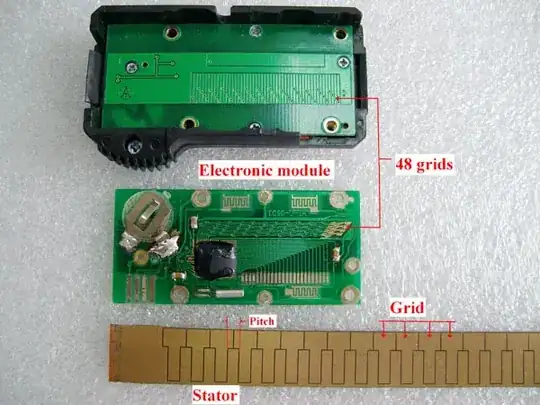

Anyway this is what i measured, cant find any of that info from google
The vertical strips that are grouped by 8, these are connected to digital outputs of the chip on blob, they are driven by PWM signals - approximating sinewave. 8phases, sinewave period 1800us(YMMV), pulse period ~5.6us. Each phase shifted by 1800us/8 = 225us
The receive plate gets the summa summarum that comes through stator by capacitive coupling. Now the receive signal is bunch of garbage mostly, but the signal peaks that correspond with output pulse rising edges do form a sinusoid. Phase of that sinusoid depends on position of the stator. Im guessing rx measurements must be timed with output pulses, and then there is some funky signal proccessing to get the phase shift, im not 100% sure on how to do the rx side of this.
As stator pattern and pattern of tx plates repeats every 5mm that means the final value is summa of coarse and fine measurements. Coarse measurement is the count of 5mm repetitions, counted and remembered just like regular encoder values, you can mess this count up is you move the scanning head on the caliper too fast, caliper loses its 0 point. Fine measurement is the phase shift measurement of the output sinusoid. These are summed and displayed on the LCD.
Here is an illustration: enter image description here

Its position to capacitance ratio to frequency ratio to value conversion. The key is using unevenly patterned conductors in proximity of two capacitors. The circuit has slow response, but works remarkably as caliper.
    Someone tore a set apart so that you can see the patterns: http://www.adafruit.com/blog/2010/11/08/digital-calipers-tear-down/ – Michael Kohne Nov 14 '10 at 01:44

The capacitance forms a resolver allowing you read a sin and cos value that when compared to the master signal lets you determine the position very accurately.
