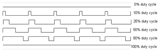

The PWM pins are controlled by on-chip timers which toggle the pins automatically at a rate of about 490Hz. The "Pulse Width Modulation" (PWM) is how long the pin stays on or off for a single cycle of that frequency. This can dim a LED by giving the illusion it is at half the brightness as before, where it is really flashing very quickly. Image of different duty cycles.
When there is a 25% duty cycle, it is on one-forth of the time. If you used for a LED, it would appear about 1/4th as bright [give or take]. (Note: as some people pointed out this isn't truly proportional but let's leave it this way for simplicity. EX: 25% isn't always 1/4th the brightness.)
