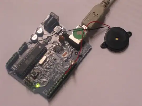

If you want to use a Piezo speaker to make simple sounds:
For just tones you can look at here on Arduino's website. You wouldn't need to store the sound file, you would just have the Arduino generate the sounds at runtime.
From Arduino's website. It seems fairly easy to implement if needed for this use.
