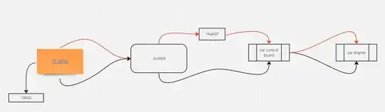

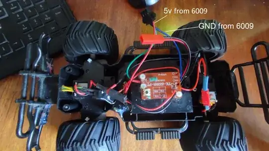

Good afternoon. I use 18650 to power the radio machine. An XL6009 is connected to the output of the TP 4056 board to receive 5V, and then these 5V are fed to the machine board. But you press start on the remote control, the TP 4056 board goes into protection and does not provide power from 18650
Both boards work individually correctly. If you connect the power of the machine without XL6009, then everything also works correctly. But need 5-6V

scheme - ibb.co/MchgJ4g
foto - ibb.co/RphZQzj

    Welcome. Please make a sketch that shows how all these components are connected. It's hard to tell from your text. Please also provide datasheets for all the relevant components. – nanash1 Jun 14 '23 at 13:06
  • scheme - https://ibb.co/MchgJ4g foto - https://ibb.co/RphZQzj provide datasheets for all the relevant components. - what components are you talking about? about TP 4056 + XL6009? – Oleg Red Jun 14 '23 at 13:45
  • Yes, TP4056 and XL6009 are ICs. I suspect you're using modules that use these ICs. Please post the datasheets of the modules. You should also use the "Edit" function to integrate this information into your question. No need to host these pictures externally. – nanash1 Jun 14 '23 at 13:55
  • @nanash1, I added – Oleg Red Jun 14 '23 at 14:08

What is the voltage at the output terminals of the TP4056 module? If it is not zero, then I agree with @nanash1, but if it is zero then I suspect the initial load is too high and trips the overcurrent/short-circuit protection
  • The initial load is not large, it launched in the air and the wheels did not even spin. I think that there is no more than 1 ampere in the load – Oleg Red Jun 14 '23 at 16:20
  • @OlegRed starting a motor from stillness takes a lot of current. If you connect a motor directly to a battery you will see sparks at the connection contacts when it starts spinning – UnknownDagger Jun 25 '23 at 21:38
Hope this helps someone too.
As a result of the tests, it was revealed that the motor consumes more than 5V at startup. And all the boost and buck converters are not very good (many for a 3V load), as a temporary solution I connected 2 18650s in series and used 4 1N5408 diodes to step down.
