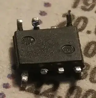

  • Hmm yeah I agree. I have a PCB that makes the piezo oscillate at about 1.4kHz at a very audible volume. When I use the circuit in the figure above, and use my phone with an audio spectrum app, I can clearly see that it resonates at about 17kHz. The problem is that the components on the PCB that makes it oscillate at about 1.4kHz are not labeled, so it is very hard to reverse engineer it. – eidetech Jun 13 '23 at 13:17
