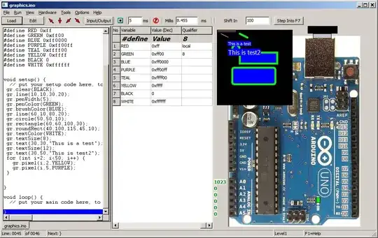

There are a few Arduino Simulator projects out there.
Perhaps one of the more mature ones is the Virtronics Simulator for Arduino, YouTube video here.
Virtronics Arduino Simulator
The Virtronics page linked above also lists a few other Arduino simulators, both free and paid.
Given the interest the Arduino evokes, there are likely to be many more such simulators out there, so no point trying to list them all in an answer here.
What is worth noting is that there is also an Arduino Simulator iPhone app: This is not a recommendation, not having seen it in operation yet.

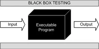

One way to do this would be to create a wrapper program for the actual code which simulates all the inputs and accepts outputs (thereby creating a feedback loop) as per the real environment. This would take variable amount of effort depending on the type of program, degree of testing and number of inputs.
Keep in mind that while writing the wrapper program, you should follow a black-box approach.
Otherwise, your outer code may not test the program as well as possible as keeping in mind the actual code while creating the test code may bias you to ignore boundary cases or problem areas (This has been observed to happen while doing White-Box Testing which is the alternative).

  • Do you know of any examples? Most Arduino code I have seen lacks proper unit tests even for the parts that do not require input/output. – Jakob Apr 10 '13 at 17:55
  • @Jakob I usually write my own code for the testing. It is practical for small projects. – asheeshr Apr 11 '13 at 05:38
