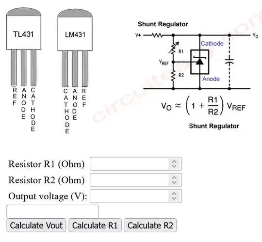

A couple years ago, I modified the voltage output of a DC power supply from 12 V to 6 V. I remember using this online calculator to get the proper output voltage (see picture):
screenshot
Image source: Circuit Easy - TL431 Voltage Calculator
Unfortunately that day I had a limited choice of resistors to pick from and the most suitable resistors values I could find were 700 kΩ and 900 kΩ. I soldered them onto the proper pads and successfully achieved a 6 V output.
20 minutes later I heard an explosion. The electrolytic capacitors exploded. I suspect my choice of high value resistors caused this, but to this day I do not fully understand why the caps exploded. Could anyone give me insight as to why this happened?

    That's impossible to answer as we don't know the original schematics, how you modified it, which electrolytic caps exploded and what was their function in the circuit. – Justme Jun 12 '23 at 05:12
  • vulubalulu balulu - Hi, Please remember the [site rule](/help/referencing) which requires that when a post includes content (e.g. text, image, photo etc.) copied or adapted from elsewhere, that copied content must be correctly referenced. As a minimum, the source webpage or PDF etc. should be linked (see that rule regarding references for books / articles etc.). In order to help you, I found what I believe to be the source webpage link & added it for you. For the future, please remember it's your responsibility to do that :) You can see the [tour] & [help] for the main rules. Thanks. – SamGibson Jun 12 '23 at 07:46
    `700 kΩ and 900 kΩ [achieved] 6 V ` I find that odd, ignoring effects of excessive resistance, I'd expect 5.7 V (or 4.4 V). – greybeard Jun 12 '23 at 07:57
