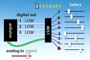

The basic premise is exactly like with digital signal multiplexing. You use the 4051 chip as a "lane changer" and read the signal of whatever lane you tell the chip to switch to. the 4051 uses 3 digital pins and 1 additional analog (or digital) pin on the arduino to create up to 8 lanes of input. Some multiplexers are chainable, so you can fairly easily add 8 more signals without needing to keep taking them away from the arduino itself.
It is exactly like the technique you already know for digital signals, just hook up the channel you read from to an analog pin instead of a digital one, then cycle through the binary states and read the analog values.
I made an animated gif for you.

    One clarification, the 4051 you mention is an analog mux not a digital mux, I would clarify in your answer because there are definitely digital muxes that cannot accomplish this because their output and input drivers are not designed for linear response. Maybe worth an added note that chaining analog muxes may impact the signal depending on characteristics of mux – naven87 Apr 13 '13 at 07:12
    It is worth noting that analog muxes are not trivial to select, the designer should consider voltage swing (most only operate within the supply range, like opamps), bandwidth, ON resistance, crosstalk, etc. etc., voltage swing being the biggest potential show stopper. – Mister Mystère Dec 27 '15 at 15:07
